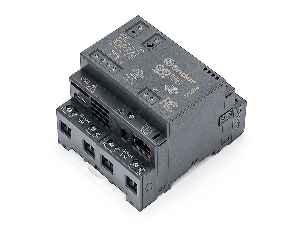

Providing the tool change does not require any axis movement then probably the best solution is to use an Arduino controller (see below for a DIN rail mount version that can be powered by 24V) to perform the tool change and link the Arduino controller back to MASSO.
The advantage of this solution is:
  • Ardunino Integrated Development Environment (IDE) provides debugging functionality
  • It allows the end user to develop / troubleshoot their own system independently of MASSO
  • Can use the IEC 61131-3 Sequential Function Charts (SFC) which are equivalent to flow charts for sequences
The last point is likely to go over the heads of 99.9% of people on this forum. IEC 61131-3 is the standard that covers programming languages for Programmable Logic Controllers (PLC). Sequential Function Charts is the variant language to use for programming sequences, as mentioned before it is basically a flow chart where you drag-and-drop chart elements and link them together to configure a sequence.
Arduino has a PLC specific IDE:
Industrial versions of the Arduino controller are available:

Thank you for sharing this. I purchased my first Arduino a few months ago when trying to get a joystick to work with Masso vs my pendant. It was a great learning experience and opened my eyes to the capability of this hardware and software.
I would like to understand the tool change use case you are suggesting this for - I don't have the experience to know what tool changes do not require axes movements. If time permits, could you give an example? I'd like to learn more about this.

+1 for the opta.
Let's not forget the portenta for those who need more inputs and outputs. The arduino PLC IDE is wonderful, full-fledged, and free.
