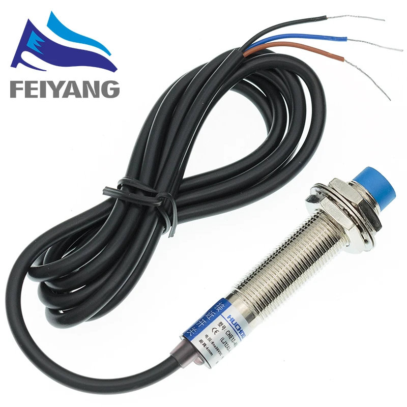

my apologies, 6-36 v inductive limit switches, link below
#Aliexpress AU $2.31 15%OFF | LJ12A3-4-Z/BX New Inductive Proximity Sensor Detection Switch NPN DC 6-36V

Because the MASSO is not designed to power high load devices. The power and grounds are intended to be used by simple contact switches connected to MASSO inputs.
Those limit switches require 300ma at 6-36v to operate, assuming you are using a minimum of 4, that is 1200ma or 1.2 AMPS and the installation instructions state to place a 1 AMP fuse in the supply to the MASSO.
The only thing with that supplier, they don't say whether they are NO or NC, you want NC so if you get an O/C in your wiring MASSO will trip hard limit alarm.
Wire as per Homing Sensor just use the black wire in place of the white wire in the documentation.
