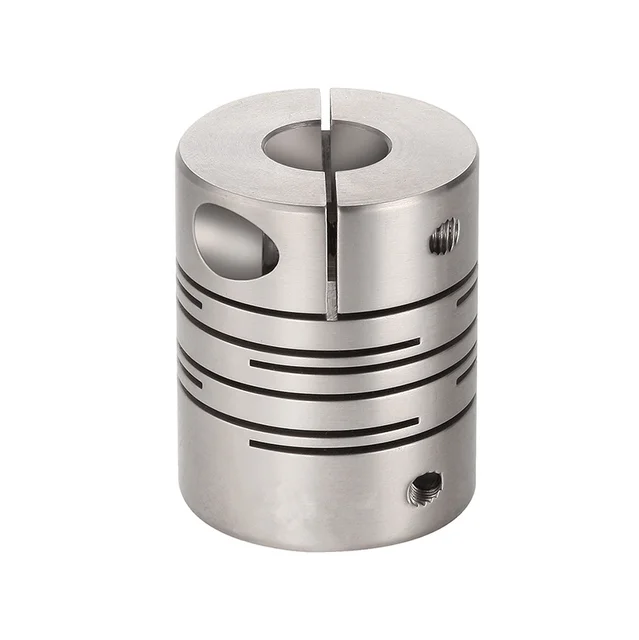

One of the things we picked in the photos is that on your Z axis you are using a flexible (spring type) coupling, this will cause issues when the axis is on load as it will wind and unwind a bit, its better to use a different type.
masso-support
MASSO Support
there are a few types, it depends on loading etc. you can use something like these below:
