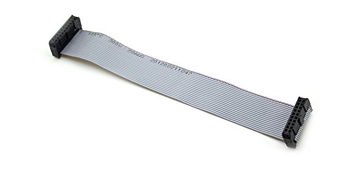

you mentioned that the drives were working earlier with 5v signals. There is a 20 pin IDC header on the bottom right side of MASSO-G3 which gives 5v TTL output signals. Will you be able to get a IDC cable as shown below and we can provide you the pin numbers, then cut the other end of the cable and screw step and direction wires to the drives:
Image result for 20 pin idc cable
masso-support
MASSO Support
IDC 20 pin connector gives 5v TTL output signals as below:
