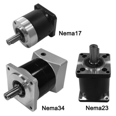

safeairone
safeairone
This topic is of particular interest to me as I m driving my ~150lb/70kg gantry assembly up and down the Y axis rails using two 1125oz/in (8Nm) servomotors directly turning 20 pitch pinions over long rack gears.
Using the smallest pinion I could find to fit on the 1/2 (12.7mm) servo shaft, the gantry moves about 3 inches (76mm) per rev way too much to have any meaningful resolution per pulse and easy to lose steps on acceleration/deceleration.
I intend to solve this problem by adding 15:1 planetary gear reducers to the Y axis servos. This will make the Y axis travel almost exactly equal to the other 2 axis, which use 5mm/rev balllscrews.
I plan to source the gearboxes from the People s Republic through eBay I just wish the output was 1/2 (12.7mm) so I didn t have to fiddle with my 1/2 bore pinion gears:
