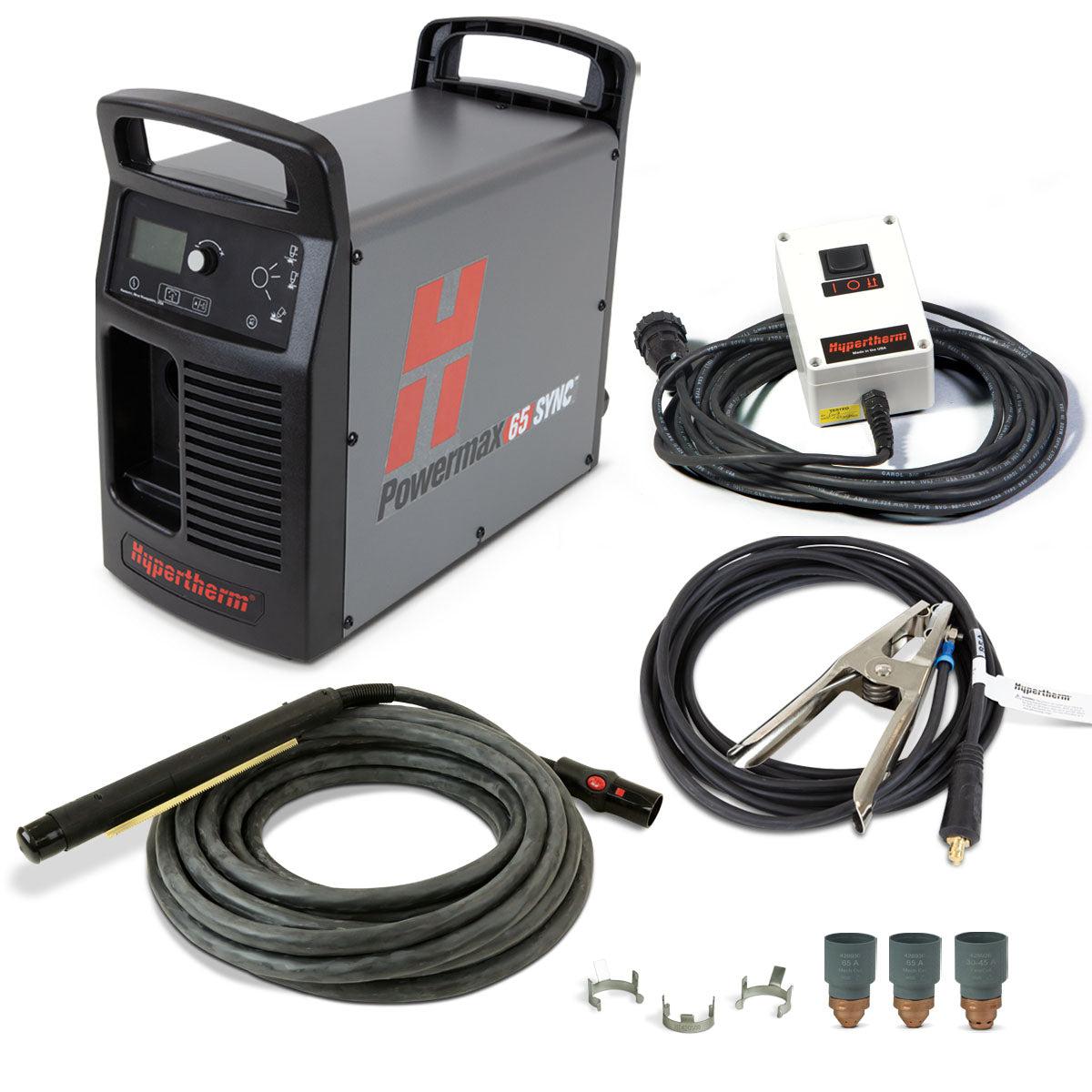

Hypertherm is probably the best of the best and out of my price range. especially since the machine torches are rather expensive. the only way i could go with that brand would be to find a cheaper solution for a machine torch? not every brand even offers them as a option.

$$ Over time will be well spent on Hypertherm as the consumable cost is the cheapest / cut. You will spend more money on consumables than on the machine itself over it's life.
America $ is about $3,300 for the unit w/ machine torch (not sure where you live). These tables are a good source of income once people know you and what they can do.

Hypertherm Powermax Series are air torch's so compressed air is all you need. 5hp 60 gal tank is plenty big , nitrogen my be used. Yes there is other torches than can use a mix of gases but they make the 65 look really really cheap LoL
Air needs to be dryer than a popcorn fart or consumables will fail sooner.
Yes the torch will cut underwater

so I noticed some units have a remote on and off feature would I be correct in assuming that this is for powering the unit down with control software? I also seen with hypertherm they have a low amp making feature I have not seen with other brands. seems they make use of argon in this for better results as well. does Hypertherm only have this feature? I could see it being useful for a lot of stuff plus I already own a big tank.
also noticed the cut thickness is not reduced very much on different materials like the everlast machines which seems to be the only low end option with a machine torch. also noticed those cheaper machines run into issues with torch height control because of the voltage divider boards doing strange things when they interact with a THC component.
also seems like hypertherm has the fine cut detail sorted out on the consumables where others do not? I also seen they have a high definition line of plasma as well but I don't even what to know what the price point on those are. the 65 is at my max if not beyond what I would like to spend. not to mention probably at least another $500 for some sort of air dryer system on top of that. I was thinking 5K would be doable but it looks like to get into something decent I will have to find more funds than what I initially thought looks like about 7.5 k might be more realistic as far as cost goes. metal prices suck these days and not to mention all the little stuff that will nickel and dime you to death you never think about.

Remote on and off can be used to run a track torch, to interface the 65 with the plasma table you will need the CPC connector and cable that plugs into the back of the machine, you need both on/off and divider voltage out to run the THC (Torch height Control). This cable can be had from Hypertherm or you can buy a connector and make your own saving you about $65. The machine you buy needs to have the CPC port, they offer a field installation kit if needed.
Don't be misled by some machines specs, the duty cycle of the machine and operating cost is what its is about. The marker system in the 45 I am not familiar with, a lot of people will mount an air scribe to mark with or they make a easyscriber that attaches to the Hypertherm Duramax torch as well. The torch like you say has the optional fine cut consumables that allows you to cut up to 11ga.
High definition plasma with true hole technology is approaching water jet quality. The Hyperthem XPR High Def burn box will run you 40 - 50k and the table it attaches to another 125k . High Def requires a mixing valve console and up to 4-6 diff gasses depending on materials cut, if you want to drool over a few of those units check out Retro Plasma Tables made in Kansas.
The 65 is a great machine it can be run single or 3 ph power saving you money. depending on your humidity you might be able to build your own air dryer separator saving you some more bucks. I have the Motor Guard M-26 on all of my burn box's.

as for humidity it's pretty bad over here in the summer so a refrigerated air drying system would probably end up being what would be needed. harbor freight has one for $400 but who know what the quality would be like from them. Ingersoll rand has one for around $800 I seen which is a good brand but only 1 year on a warranty even with them.
Hypertherm seems to be the way to go i'm just torn on a $3,300 price tag for the 65 and am not sure if a 45 would be big enough to not out grow?
