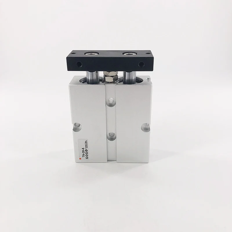

Nice Ross, did you run a 2 way cylinder or a single acting with a spring return? Nice set up by the way, I will post some pictures of my machine.- Ben

Here are some of the bits I bought. All from AliExpress, cause it is to hard to find it in Thailand.
1PC HGR20 Linear Guide Width 20MM Length 200MM with 1PC HGH20CA
You have to use a linear glide for the scribe because the pneumatic cylinder rod has too much flex n it. Plus I had problems getting the scribe to the job using low pressure and it was still pushing to hard on the scribe.
Even at the moment it still might be a bit heavy, might have to tie some helium balloons to it!
Just think what people will say when they see it working "HEY WHAT ARE THE BALLOONS FOR?"
From Ross.
