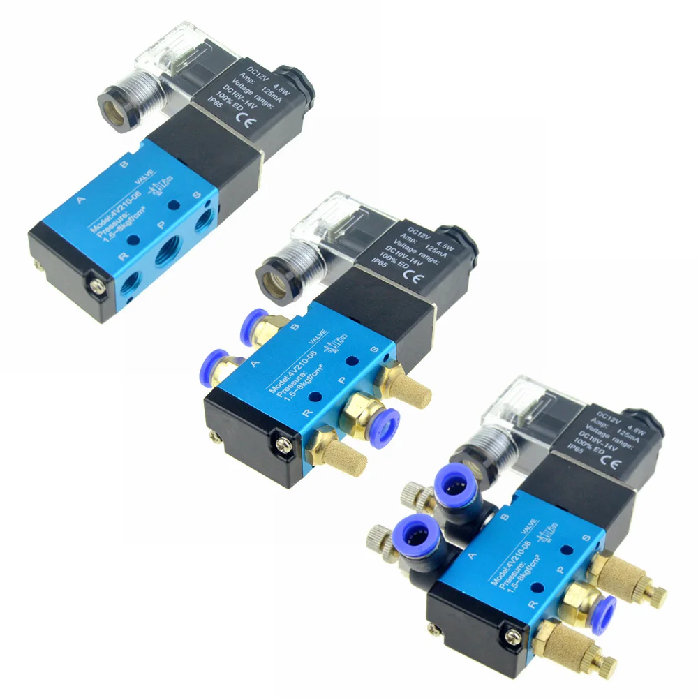

I am hoping to use The Masso plasma postscript and have the "Mach3 thc with scriber"postscript incorporated to the Masso postscript. (M08/M09 to turn scribe on/off.)
Postscript came from Sheetcam.
This is the Solenoid valve that I use and it works straight from the Masso relay outputs.
Thank you from Ross.
  • Mach3-THC-with-scriber.scpost
jcoldon
jcoldon
send an email to less at sheet cam he has one for mach 3 it looks like you have your scribe going up and down with the z
so what you do is use the marker tool in sheet cam for the scribe lines tell less you want the post for the marker tool and not fire the torch
then assigne an out put from masso to activate the tool
hope this helps
